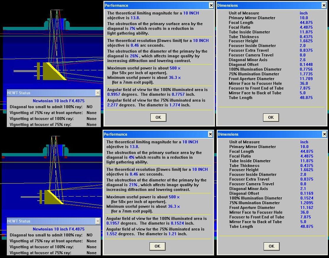

I have a 10" f/4.5 dob that currently has a 2.6" secondary mirror. I am contemplating changing to a 2.1" secondary. The attached photo shows the current (top) performance and dimensions with the 2.6" secondary, and the performance and dimensions if I were to change only the secondary (bottom). The reduction in the obstruction (from 26% to 21%) is a plus (more contrast) but I'm not sure what to expect visually by the angular field of view of the 75% and 100% illuminated area. They are significantly smaller in size with the 2.1".
While not dedicated to planetary viewing, I enjoy the planets and spend time on them when they are in good position but I spend most of my time on DSO's. If it makes a difference, the scope has a 2" focuser but all my eyepieces are of the 1.25" format. (24mm Pan, 13 and 9 Nagler, 5mm TAK)
Would changing from a 2.6" to 2.1" secondary on this scope be of benefit or should I leave it as is?

A few years ago I changed the secondary in my 12.5 f/6 from a 2.6 to a 2.14. I recall doing considerable research on what was "appropriate" for a fully illuminated field. As I recall, the target to shoot for with a fully illuminated field was something between 0.3° and 0.5°. Your choices are quite widely separated with the fully illuminated field being either 1.0° or 0.2°.
Without having any real experience seeing a dropoff in illumination on any scope, I would still be hesitant to reduce the fully illuminated field to 0.2°. So if I was choosing, I would probably stay with the 2.6 inch secondary size. If this was a scope on a driven mount, then I might be willing to try the smaller secondary.

Don't know where Newt's numbers come from, but
the data indicates ~8.5" diagonal-to-focus separation. This would result in ~0.25" field of
full illumination diameter, and ~76% illumination
12mm off-axis (all you need to worry about with 1.25" ep barrel).
As for the contrast effect, 26% obstruction results
in 0.87 contrast degradation factor, and 21% in 0.91
contrast degradation factor. This is comparable to
1/5 wave p-v and 1/6.1 wave p-v of spherical aberration, respectively. Not much of a difference
practically, but it could be as a part of an effort to minimize all error sources inherent to the system.

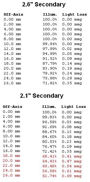

Thanks for all the replies and the link to the Mel Bartles secondary calculator. I have attached a photo of the results using both mirror sizes.
The columns show a list of off-axis radius, the ilumination for this circle and the light loss in magnitudes. If the illumination falls below 70%, that line is shown in red.
The Tele Vue website lists the 24mm Panoptic as having a field stop of 27mm which would be a radius of 13.5mm. Looking at these results, does that mean that I would still have over 75% illumination across the whole field with that eyepiece and a 2.1" secondary? (roughly 95% illumination with the 2.6" secondary)
With this additional information, are there any other thoughts on the benefits of (or not) switching to a 2.1" secondary on this scope?
