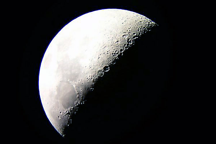

P.S. I should perhaps state my reasons for wanting to hook up my SLR's. I'm still learning alot about astronomy, so serious astrophotography is probably out of my league. What I do want to accomplish is to take nice pictures of the moon or other planets without having to hold up my camera and lens to the EP, as I have done previously. The attached photograph of the moon was taken with a 25mm plossl and at the time, an Olympus C5050 help up to the EP. Now that I've upgraded to digital SLR's, I was hoping to get the most quality out of my lunar shots possible.
amstel78's attachment for post 24921
