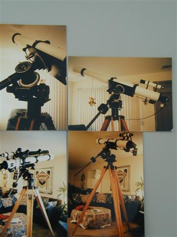

I'm by not means a expert, but I've stacked an 80mm f/9 on a 4" f/15. The advantage is by adjusting the ota's at a right angle to the counter weight bar, it is easier to get a good balance. By mounting them side by side you balancing becomes that much more complicated. If it's a portable set up verses fixed, could also make a person change there minds. Alan
tx4coe's attachment for post 72084
