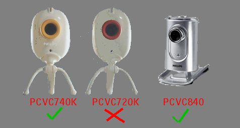

There have been several sellers posting Toucam 720 or 730 cameras on Astromart, without indicating that the 720/730 is not suitable for astro work. Granted, buyers should research what they are buying, but many ill-informed people hear "Toucam" and immediately think of the hard to get Toucam that has been used to excellent effect for planetary imaging, when in fact only the Toucam Pro 740, 750 or 840 are suitable. The Toucam XS (720) employs a CMOS sensor while only the 740-750-840 use CCD sensors.

Only the Philips Toucam Pro (740,750,840) are useful, as well as the Philips Vesta 675,680,690. The Vesta "fun" falls in the same category as the Toucam XS. See the attached image of Good and Bad Toucams.

Benschop's attachment for post 13263

Good post Len. I went through the same thing last year when I was looking for my Toucam Pro 740. I kept seeing the 720 on Ebay for around $35. Glad I did my homework and ended up with the right one. Now I see that the 840 is out and is supposed to be just as good as the 740. Has anybody seen any good pictures taken with the new 840? I know there are not too many outhere, but I haven't seen any yet.
