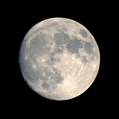

Dave, I gave it a try. Registax seemed to have trouble chasing the moon around in the frames, so I cropped each image first so that the moon is roughly centered in each frame. My crop was a 400 x 400 px square, so I used the 256 size alignment box. If I centered the moon in the box, it resulted in some of the images falling outside the stack. I'm not sure why. I tried setting the alignment box off center a little, so that a good part of the moon was completely in the box, and that seemed to work. For the image here, I also sharpened the final stack and adjusted the color a little. Let me know if this helps, or if you need more info.
Steve
Steve OK's attachment for post 144404
