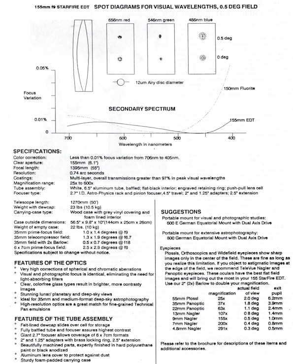

Posted 03/25/2007 05:45AM #1
The 1992 catalog describes the 155mm F9 EDT color
correction as "less than 0.01% focus variation from
706nm to 405nm." The later 155mm F7 EDF model had
the same specification.
Average selling price shown on telescopebluebook.com
is $3700 for sales after 2001.
Heres a spec sheet attached.
m87's attachment for post 112686
