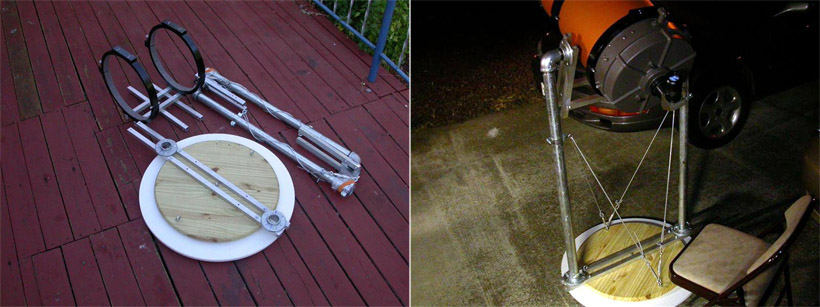

If you can figure out a way to get your 14" off the forks, I have had some success building an alt-az mount for my old C14. It collapses down easily, and the OTA goes in the front seat. Setup time around 15 minutes. This scope has made it to several starparties, and the comfort level is quite good.
As for refractors, you could get an Orion ST120 and mount it on top of the Meade 14", that would be a nice setup !
David Simons's attachment for post 95733
