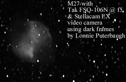

I recently imaged the horsehead nebula with one of these and also completed one of the first ever tri-color images with one. I've had mine since early March. They are simply amazing! I have not used an eyepiece since this great observing tool arrived. I use to be the most frequent visitor to my club's dark-sky site with my 16" truss-tube dob. I haven't been there once since the camera arrived. I now work from my driveway and use my 4.2" scope under heavy light pollution to see nearly as much as at the dark-sky site. This camera will triple the aperture of your scope at a minimum (in the realm of light-gathering ability). I have an expensive ccd camera also, but this one is much easier to use and more fun. It can be used for more things, but it doesn't make images as nice or as deep in magnitude as the much more expensive integrated and cooled ccd camera. The Stellacam EX is the biggest advance to come along in amateur astronomy in the past decade, in my opinion, and when everyone eventually gets to see what they can do, everyone will start using them. I will never purchase another eyepiece and I am contemplating selling some of my eyepieces that I spent hundreds of dollars on. They will be worthless in time as the quality of these cameras improve. If you need more info, check the Yahoo videoastro or stellacam EX groups. We have dozens of images posted there.
By the way, I now observe real-time with the live images blown-up on my 20" tv inside my house. I control the scope with The Sky software from over 60 feet away. The image scale is incredible and I don't have to worry about dark-adaptation or cold weather. It is like looking through the largest eyepiece you've ever seen! The stars twinkle and the atmosphere is easily discernible for the same feeling as viewing with an eyepiece, but there's much more there to see. For me, the camera adds about 3 magnitudes to what I can normally see with an eyepiece. The only thing that suffers is some field-of-view, but you'd have to give the FOV up if your scope was 3 times larger anyway. Have I convinced you yet? Here's my latest image of M27 from a 4.2" telescope.
