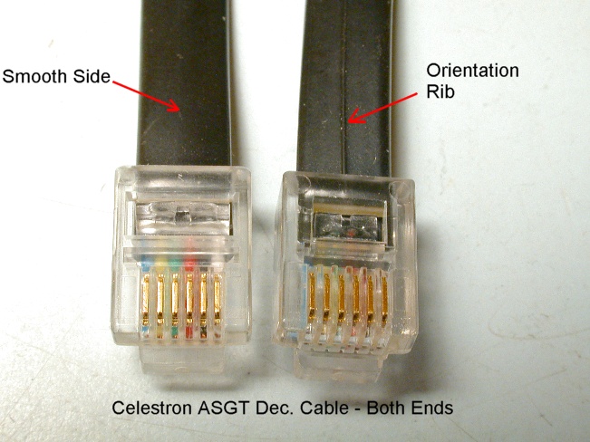

10. While on the subject of cables, take a close look at your Dec. motor connector cable and both RJ11 connectors. (See attached photo.) Note that there is an orientation rib on one side of the cable and the other side is smooth. When you hold both RJ11 connectors side by side with the gold contacts up, one end of the cable must have the ribbed side up as it enters the connector and the other end must have the smooth side up. If your cable has ever been replaced or repaired, and it was done wrong, the Dec. motor won’t work right because the wire sequence is reversed.

mrvolvo's attachment for post 128600
