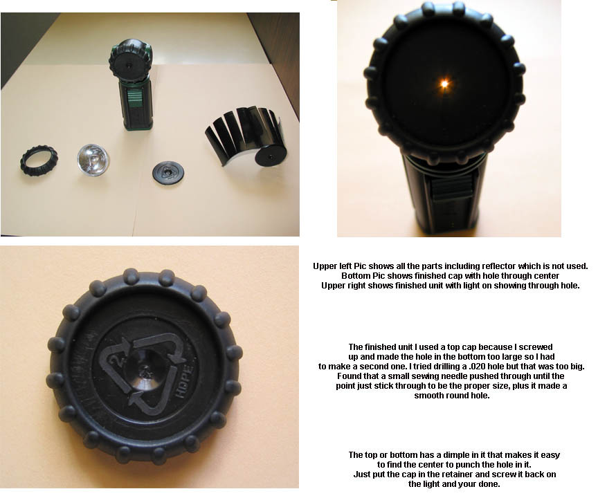

Here is how I made one for portable use. I used it for my SCT at about 35-40', in darkness of course. I actually placed it in my garage and then looked down the hall through the open door.
fblue's attachment for post 106352
