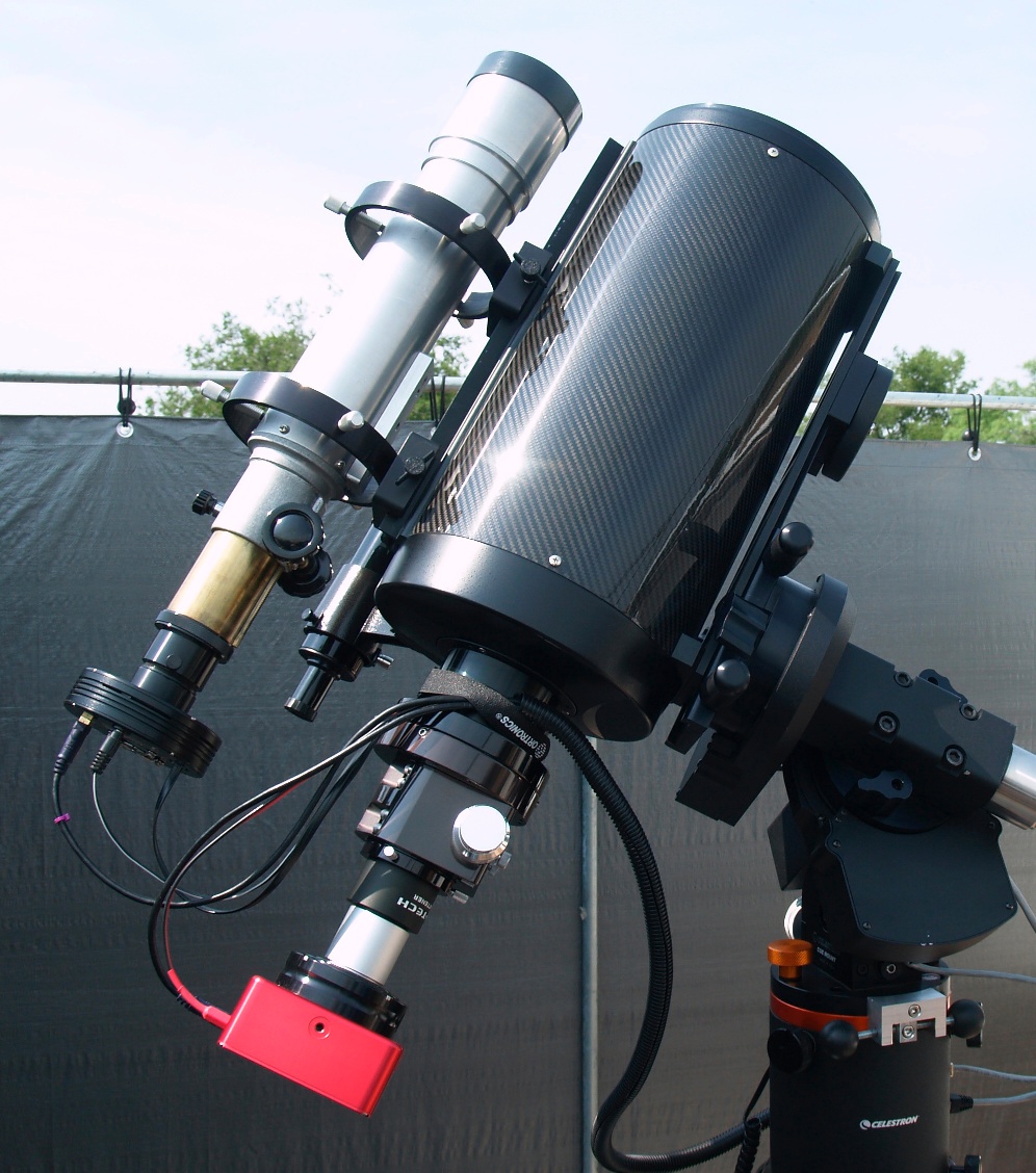

I use an 80mm f6.25 as a guide scope with great results with my AT8RC on a CGE mount. The 80mm has a little more light grasp and the longer 500mm FL gives better guiding with longer FL scopes.
ccdfreak's attachment for post 144858
John
