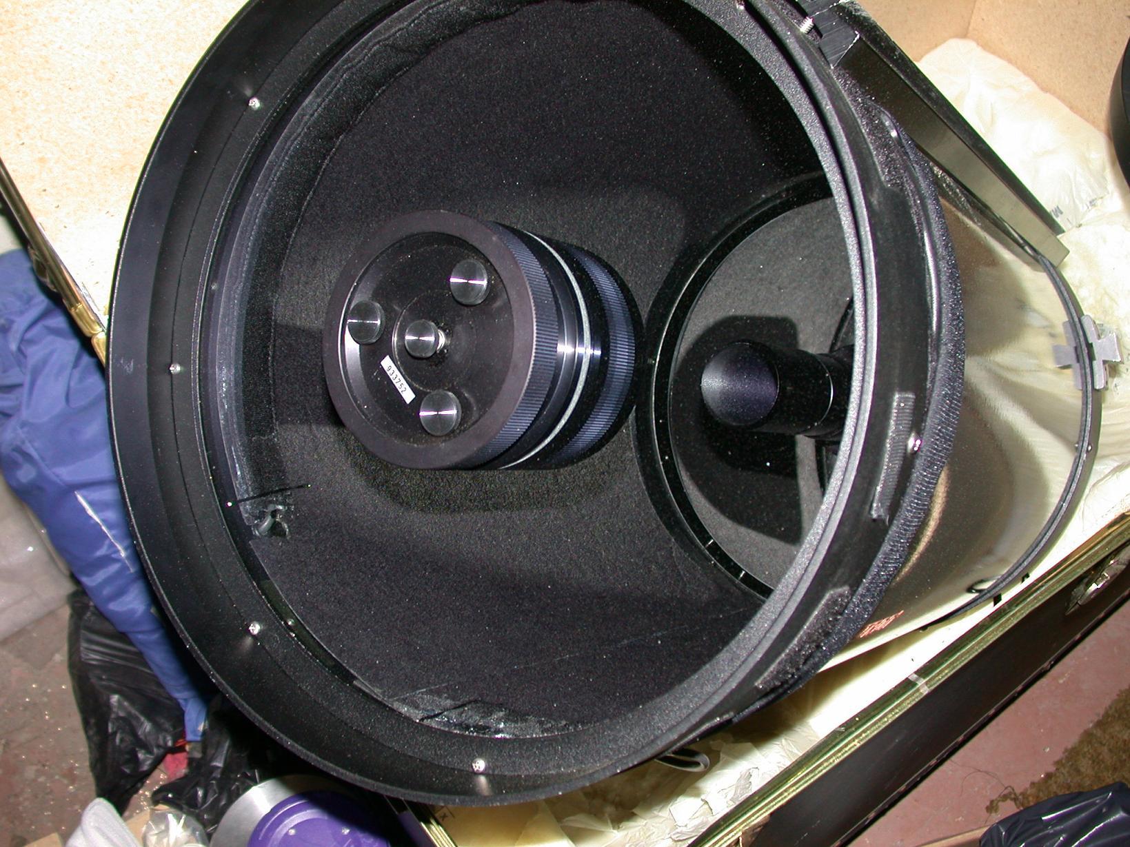

I have written on this elsewhere, the material below will get many issues out on the table. Regarding your 9.25 the first step is to get an insulated dew shield (such as the Just-Cheney dew shield) and the second step is to consider active heating. For my C14 I went to an internal dew heater for which I will try to append a picture to this post.

After struggling to keep my C14 frost and dew free for years I finally made the extremely radical and not widely emulated step of putting the heating strip directly in the tube. I could go on about this at great length, but to sum up, if you have it outside the tube, it's because you're trying to put heat in the tube, and if you're trying to put
heat in the tube, you might as well not waste a lot of amps trying to force it through aluminum which is doing its best to conduct it away from where you want it to be. Fact is, I haven't noticed "tube currents" on the C14 any more than I did the other night with my FS128.

A further point: When I actually studied the C14 with its internal dew heater (a 2.1 amp C11 heater that is putting out about 23 watts on the inside of the tube) I was astounded to note that the heat on the corrector was only barely detectable and the heat on the tube wasn't
detectable at all, to within the resolution of this instrument. Indeed, what I saw was, a huge delta in temperature between the sky side and the ground side of the instrument. My conclusion at the time was that the earth-sky thermal exchange mechanism basically swamps all
the other conditions going on inside the scope. I began to have an image in my head that the 23 watt heat source is really pretty feeble, that the strip still loses a lot of heat to conduction through the aluminum tube, that the air rising to the corrector is at best only a degree or two warmer than the rest of the air in the tube, and that
the cooling of the aluminum OTA rules the roost.
