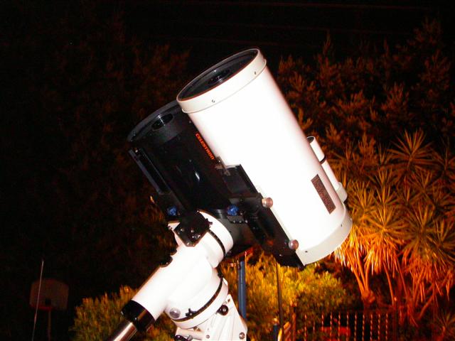

The picture is from a side by side of a Celestron 9.25" and the SCT225.
David Simons's attachment for post 118371
