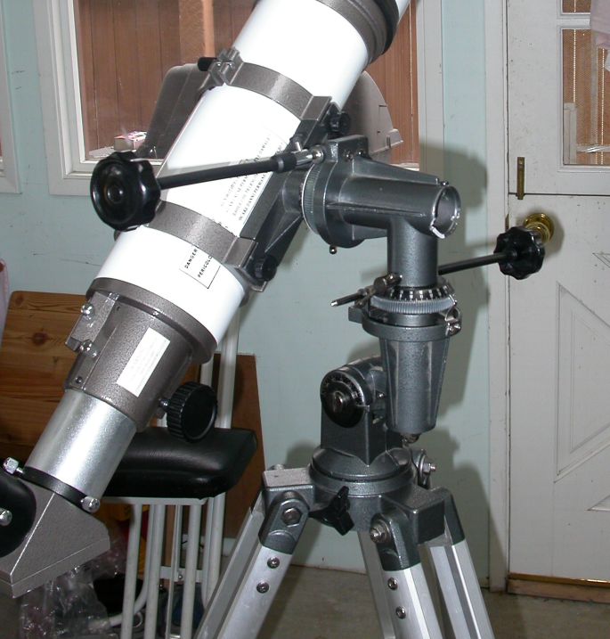

You prefer an alt-az mount. As has been previously mentioned, these small EQ mounts can be easily converted for use as a ALT=AZ mount, most often without modification. Simply points the polar axis to the zenith rather than at the north pole and magically it is now an ALT-AZ mount, the RA axis is now the Azimuth axis, the Declination axis is not the Altitude axis. And the bonus is that it has nice slo-motion controls for centering and tracking at higher powers. The photo is an 4 inch refractor mounted on a Meade 4500 eq mount setup in the Alt-az mode.
