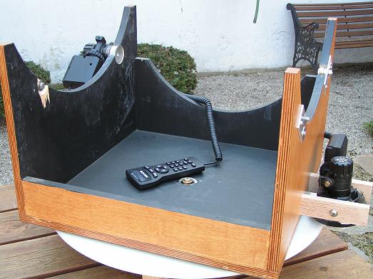

I've tried Mel Bartel's system, but it required a lot of tweaking and you also needed a laptop. I retrofitted a Meade DS mount onto my 14" truss. All the brains are in the Autostar controller. Total cost for parts was about $200. Here's a link to it:
http://homepage.ct.metrocast.net/~hfs/Projects/Robo14/robo14.htm
I bought some new 1.25" tubes a few weeks ago so that I can redo my 14" into a more lightweight scope. I'm also going to redo the GOTO setup. The altitude speed is fine, but the azymuth speed is excruciatingly slow. However, the GOTO's are extremely accurate!
I used DS motors, but motors from an LXD55 or LXD75 mount could also be used.

hfsarber's attachment for post 119602
