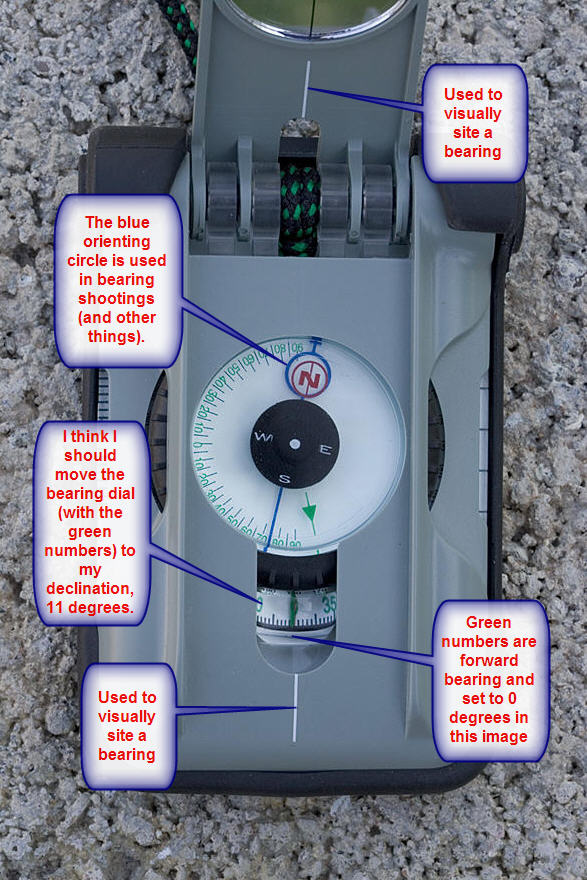

Sure would apprecaite some speific help with reading a compass I picked up today at a neighbors yard sale. I have the manual, and yes, I did read it but still confused. I set the magnetic declination as per the manual for my area 11,27 East. Here are my specific questions if you can help.

2. On my specific compass, the blue graduation dial, the one with the blue circle is for compass bearings (forward/back). In the image below, I have it set at 0 degrees. The red (N) is the magnetic north arrow. How do I set my mount up accurately with a compass like the one below. BTW, I have asked Brunton Compass but they weren't any help.

So what do you think,
Thanks for all the help, links and suggestions. Please don’t take this wrong and I do appreciate the help. I understand where to find my magnetic declination for my area, as I listed it in my original posting, and HOW to configure the compass for that. I just don’t know how to use the compass to setup my mount. I realize it won’t be perfect and only close.
So, the compass is setup and configured for my magnetic declination. When I set it to 0 degree’s bearing (as shown in the image below, green numbers), the red magnetic arrow point to magnetic North. If I move the green dial to my magnetic declination of 11 degrees, I would assume that would be true North? I could then sight my telescope in via the white marks on the compass (called a forward bearing)? Make sense?

... last image promise ...
This looks correct to me. The compass is pre-set (internally, not the green numbers) by me for my declination in my area. This corrects for the declination. If I want to forward shoot a bearing for my mount, then I set the green dial to 11 degrees, then line up the 2 white lines with the blue one?
