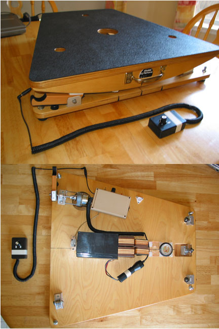

I would assume you are talking about the new Type 6 design or the older Type 5 design?
The new design is pretty nice looking, but it is tall at 7 inches. The 10" would work well on it though.
I have not used one myself, but I have heard the older Type 5 is a bit hard to set on the adjustable degree steps.
Over all though I have heard good things about them.
I have an Affordable Equatorial that was sold by Astrosystems that is no longer available. I like it and it does a good job of tracking. It is 5" tall and can be as little as 4" if I don't have to raise it to clear the rocks and stuff.
There is a person selling a round EQ platform here on Astromart that is suppose to be good also.
