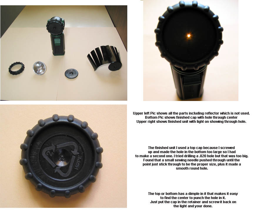

Posted 10/06/2005 10:24PM #2
You can make your own artificial star for a few dollars. Here is a pictorial of how to do it. It works great on an SCT.
The lasers are a pain and as stated before, not very accurate for an SCT.
