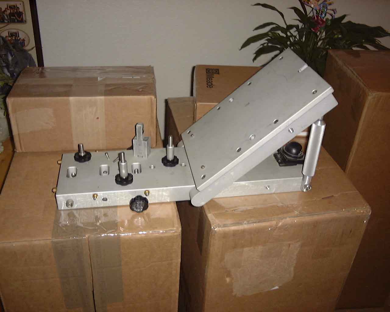

I used a Mettler wedge on my 8" LX200 and it worked great. I started with the meade standard wedge, and after a couple of weeks, I sold it and got this mettler. It easily handles the 8" will handle up to the 12" with no trouble.
(mine is for sale, might be sold but if you have interest, I will keep you in mind if the other potential buyer decides not to buy it.)
If you want to see my attempts at imaging, goto http://www.waynesastronomy.com and go to the images section. The equipment section shows the wedge loaded with my 8" and a televue 85 piggybacked to the 8".
Melnmarn's attachment for post 102505
