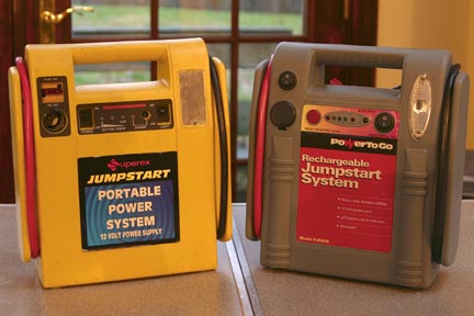

Posted 11/28/2003 08:45PM #2
With rechargeable Gel-Cell systems such as "Jumpstart" available for as little as $23 from on-line auction sources, why risk crashing (or worse yet) damaging your PC as a result of feedback pulses from the steppers or rapidly changing current levels should an uh-oh happen with the external load (yeah, but that stuff never happens, especially in a wet, dew-prone, outdoors environment... right Murphy? shocked)
You could also fabricate a system yourself, though the ready-made commercial units are less expensive than buying the parts and doing it yourself! I prefer Gel-Cells batteries, as they hold their charge for an extreme length of time (we're talking months, not days!), can be readily recharged numerous times from any level, and do not tend to dip dramtically as they are discharged.
http://www.astro-nut.com/gel-cell.html
This allows you to have complete portability as well, be it to go to a further corner of your yard or to a remote site where an AC source is just not available.
