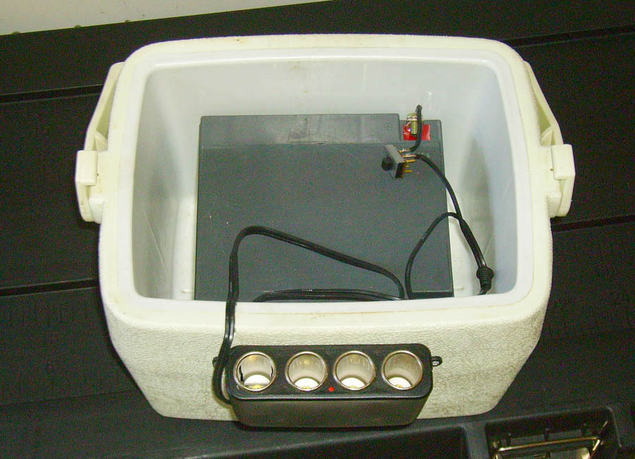

I just wanted to post my recent solution to remote power. I bought a 26 amp hr gel cell and installed it in an old "6-pack cooler". A 4 outlet plug unit and a inline switch were added to make a nice portable unit. I use a 1 amp wall wart to recharge which will also fit inside the case.
Walt
Walt
