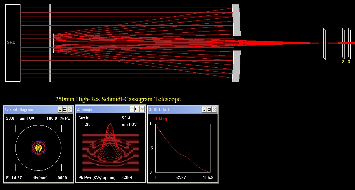

Maybe someone with ties to the "industry" can answer a question for me. Why are there no SCT's designed for high resolution/high contrast observing? The cost of a 10 inch MAK or Refractor is well beyond the financial abilities of the people I associate with yet I find this size of telescope to be excellent when you balance the size of the scope against high power image brightness, detail, and average seeing conditions. A 10" cooled high definition SCT produced by Celestron or Meade should be affordable to all who desire a medium cost, large, high power instrument.
Forget the computerized bells and whistles which can break or fail. Just an affordable pure high performance instrument on a nice GEM. Yeah, I know I'm old school and probably out in the twilight zone but, for me, there is something special about observational simplicity.
The image is a "paper" SCT telescope that I have been playing around with off and on for a few years. It has a 26% secondary obstruction, 100% illumination to 1/4 of a degree field of view. Image contrast should be equal to a 185mm APO and the small relative obstruction would make the instrument less sensitive to seeing compared to "standard" SCT's. At F/14 multi-element eyepieces are not needed and longer focal length eyepieces would render high powers with good eye relief. Hey GSO, care to make a lunar/planetary Schmidt? I would buy one 8)

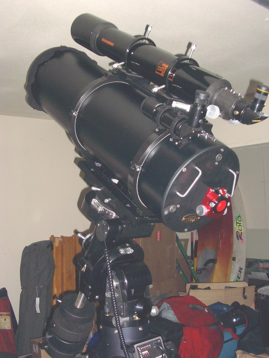

Posted 07/14/2008 02:44AM | Edited 07/14/2008 03:04AM #6
While I recognize this is not an "SCT", Bob Royce is making a limited number of 10" F/20 Dall-Kirkham reflectors specialized for lunar, planetary and doubles. I ordered one of the initial five prototypes and have to say it was a great decision. The scope, #3, is easy to set up, a snap to collimate in the daylight (can you say that about a cat?) and when the seeing is good it puts up stunning visual images. It is not inexpensive but for such a superbly crafted instrument with conical mirror, built in cooling fan, a two-speed Moonlight focuser, curved diffraction-free spider and 25% CO I would not expect it to be. Its 5000mm focal length lets simple eyepieces shine. When the better skies of Fall and Winter arrive, I plan to try the Zeiss 10mm monocentric. Best planetary eyepiece I have ever used and a fitting choice for Bob's scope!

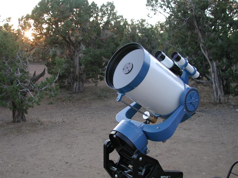

Posted 07/15/2008 02:38AM #9
Keith,
You mean like this? 1965 Celestron Pacific C10, 10" f15, 27% obstruction.
Cool down is a bear but optics are SWEET!
Dave
