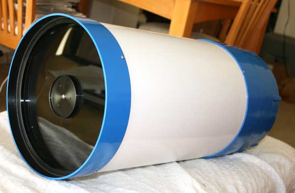

Posted 07/17/2008 05:22PM #12
Hello:
I have a 10" Celestron SCT made in 1967. It's f/13 and has a central obstruction of 30%. The image quality is excellent. While your design has a 2.6" secondary, when you add the size of the secondary mirror cell and baffle, the central obstruction will end up around 3".
It's been my opinion for some time that the central obstruction issue is way overblown. People consider the usual SCT as a non-planetary instrument since they have a 33% central obstruction. I think these same people would be quite surprised to find that HST also has a central obstruction around 33%, and I haven't heard any complaints about HST's planetary images.
Cheers
Mike Connelley
msc@ifa.hawaii.edu's attachment for post 123653
