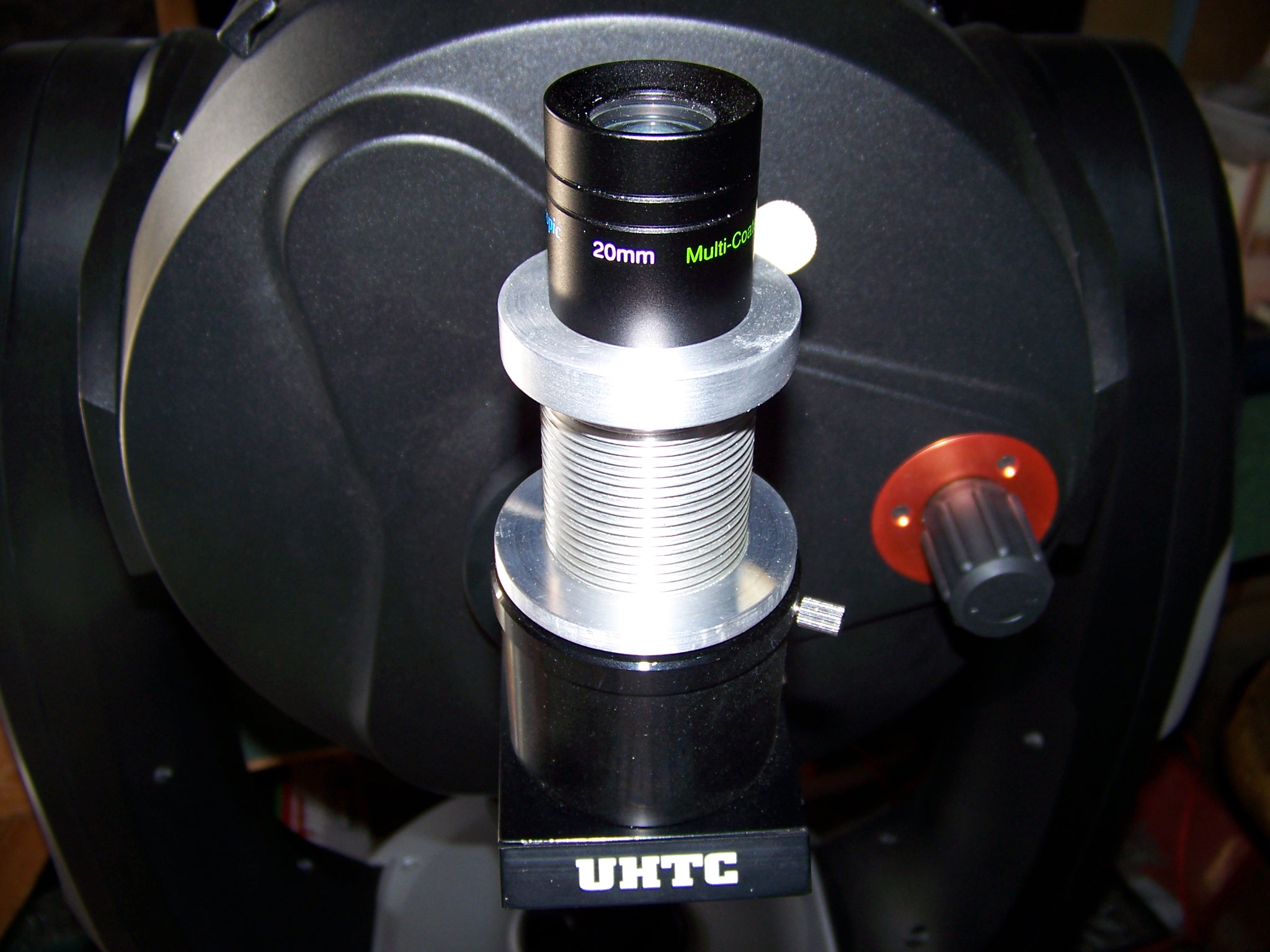

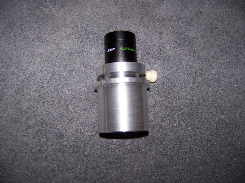

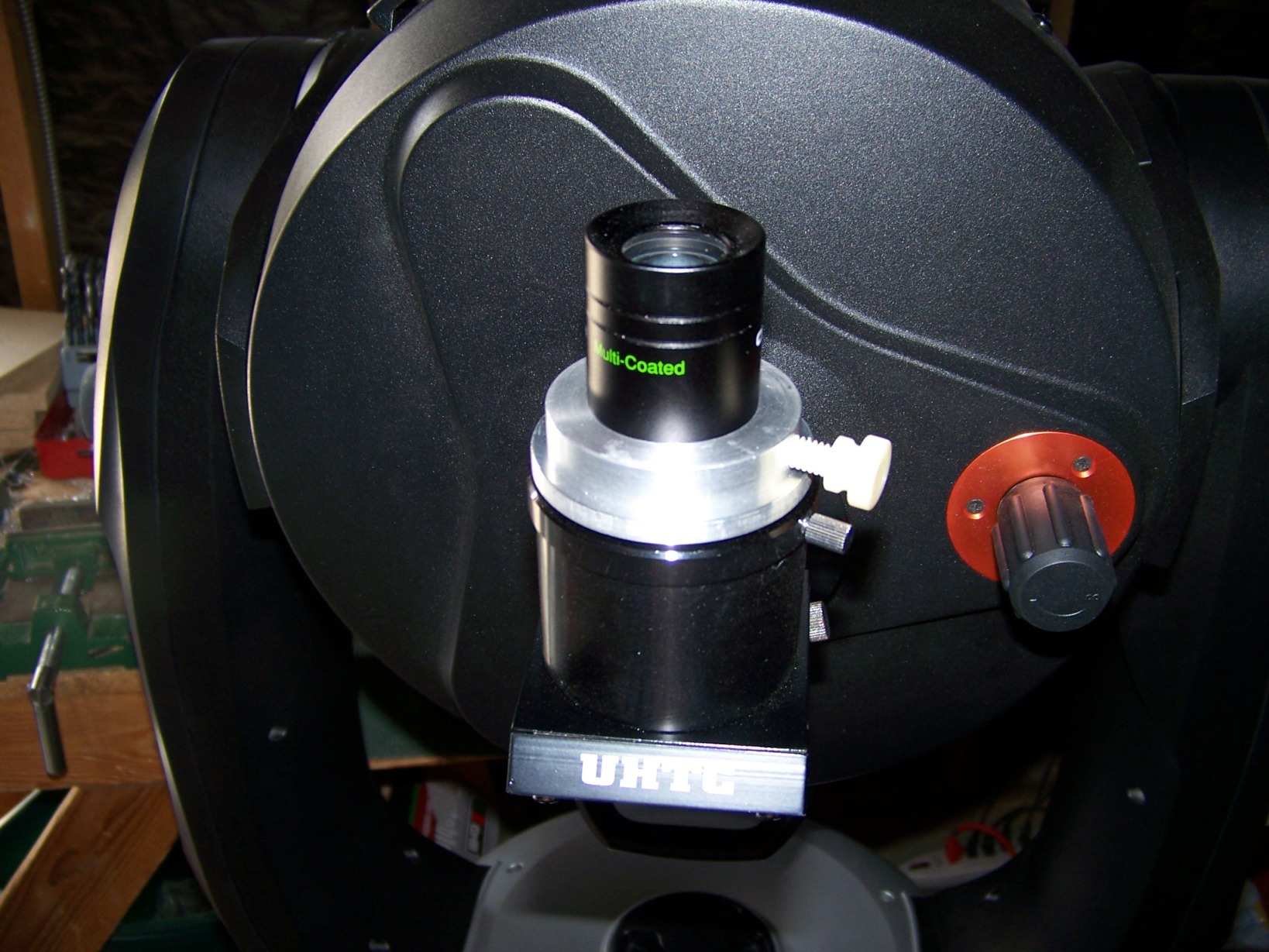

I just thought I would share my simple solution for SCT image shift. Since I refuse to pay the high price for some aftermarket focusers I made my own. It's a simple helical focuser. It drops into my existing 2" diagonal. It was made for 1 1/4" eyepieces. The threads were precision machined for a nice smooth fit. There is no play even when extended to 1 1/2". I use the main focus knob on the OTA for rough focus and the helical for fine focus (high power planetary observing). For visual use it works quite well. I tried to find something like this in the aftermarket arena but found nothing.
I didn't spend the time to knurl the focuser since the eyepiece thumbscrew acts as a fine focus knob.
I also use the helical focuser when I want to mimic the waves of defocus in Aberrator. I can do it easily now since I know the thread pitch (12). One turn is .083" of defocus and if my calculations are right this comes out to 4.79 waves.
