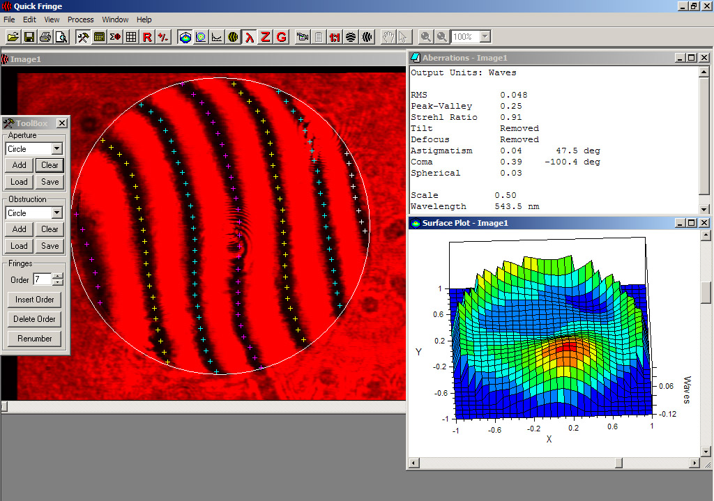

Your question about Strehl is legitimate, but by itself it does not answer the whole question about an optic. Can you have high Strehl and have a not-so-good optic? The answer is yes. In these next 4 images I have captured the process of hand correcting an optic that starts out with a respectable Strehl of .91, and then over a period of about 4 hours convert it to an optic that I can place into a tube assembly and sell.
Optical glass is never really perfect so that if you place a perfect figure on each surface you would get a final perfect wavefront. The internal quality of each element must be extremely high for that to happen, and this is not always the case. Small broad imperfections exist internal to the glass, so one must apply spot hand corrections to achieve the highest level of performance. In my case I can spend anywhere from 2 to 8 hours (or more in some cases) to slowly bring the optics to perfection.
This lens started out with .91 Strehl, 1/20 RMS, 1/4 wave P-V. The numbers, especially the Strehl, sound ok, and I would guess that this lens would pass some company's specs and be on the way to some lucky amateur. Does it work at this level? Well sorta. It would show detail on Jupiter at most powers, but there would always be a bit of something lacking.
The fringe pattern shows a strong S shape which means a non-rotational aberration caused by tiny differences in density internal to one of the elements - a high spot on the wavefront toward the front and a depressed area toward the rear. Spot figuring must be done to flatten the wavefront. 1:00 pm - time to start the hand figuring (basically working the polisher for 5 minutes or so, and then letting the lens sit for 15 minutes on the interferometer until the glass has reached thermal equilibrium so a new reading can be taken).
RC
