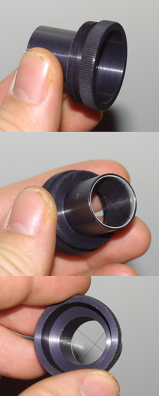

I have the same problem with my Antares finderscope - plus I have examined two others Antares finders it was also impossible to achieve focus on a star and the reticle at the same time. It seems it's a ''feature'' of the EPs that come with Antares finders. Anyway, it's not a very good EP.
I have bought a screw-in metal filter-type ring with a laser-etched glass reticle from Mike Spicer, a member of Astromart (see ad at http://www.astromart.com/viewad.asp?cid=165236). Beware, however, that this reticle causes a lot of vigneting in my Celestron 26mm plossl. See photos.
Jean-Marc Gélineau
JMG's attachment for post 64104
