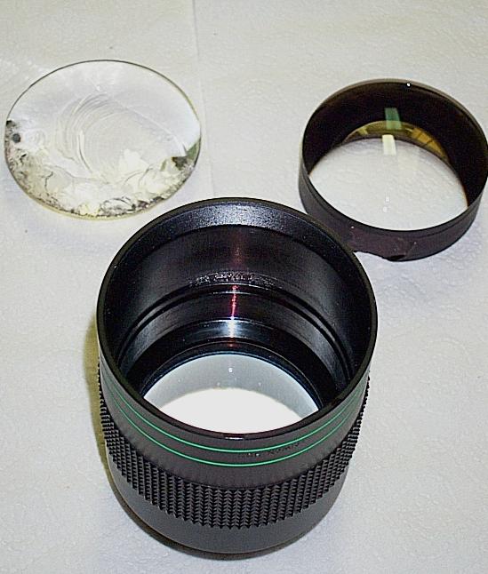

Well I have experience doing my own fixes to my used scopes, because they are all Meades and Orion is not the only co. who won't exactly sell you a spare lens like Tele Vue just did for my broken 35mm Panoptic :-) Al Nagler is a nice guy to talk to on the phone. The value brands just don't do things like the companies who are in the telescope optics business for love of the hobby rather than profit.
dashfive's attachment for post 62299
