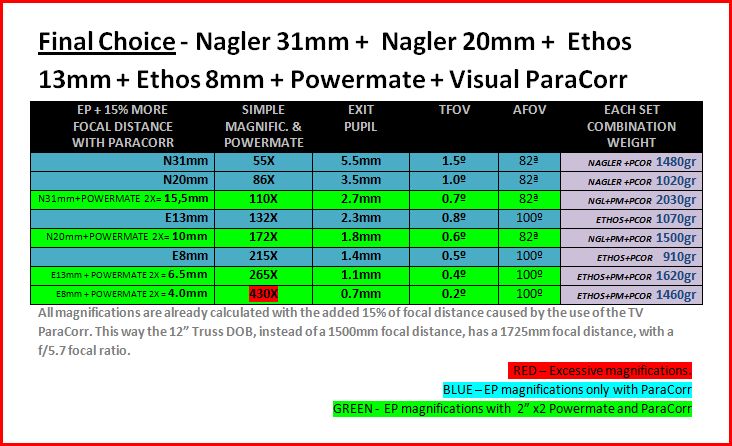

Here is my final, REALLY FINAL CHOICE, of the EP set I'm going to buy. This week I'll order half and in a month or so the other half.
pmesquita's attachment for post 130246
