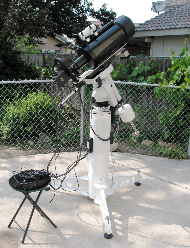

This is my MI-250, very nice mount and cost used is about $5000 with a portable pier. Could be less without a pier.
fblue's attachment for post 141503
