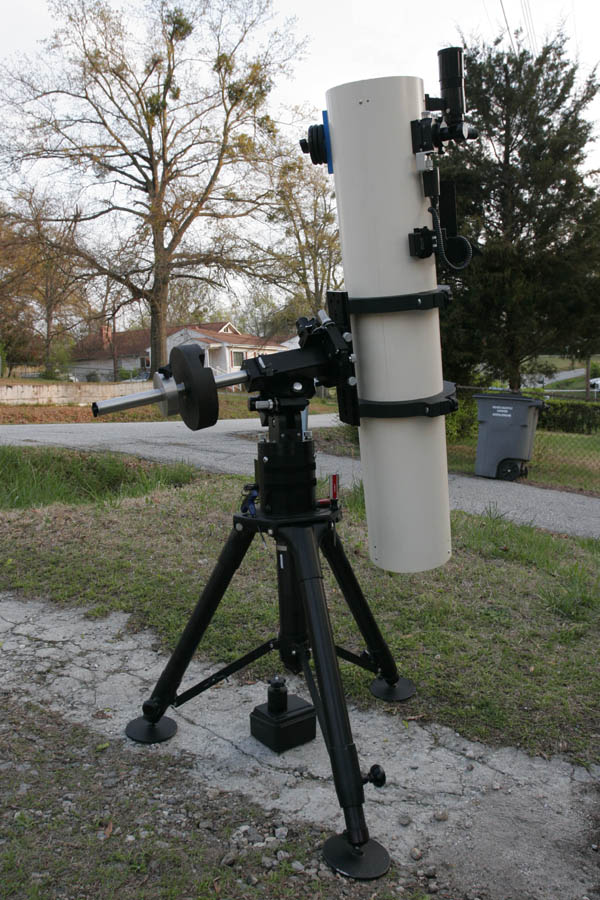

Quickset has made some great tripods. Of course they are very expensive new so the trick is to find a nice one that hasn't been used much. Many of the ones on the big auction site have been heavily used so you have to look carefully at them. They vary quite a bit in size and load capacity. I have a Samson one that is a compact version, only 2 ft. long folded that I use with a Vixen Porta head for quick looks. I also have a 20+ lb Gibraltar model that is well matched to a CI-700 mount and has some serious carrying capacity. Both of them work great, it's just a matter of matching the tripod with the right load. What were you thinking about mounting ?

Joplin Motisher-Chittenden's attachment for post 128331

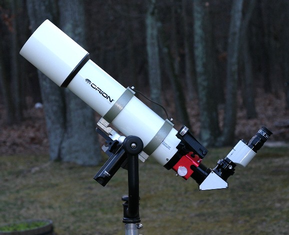

Here is a photo of a Orion 120mm F/8.3 on the Houston-Fearless. With the stock tripod, it vibrated with every beat of the stepper motor. With the Houston-Fearless, it was rock-solid, vibrationless focusing at 500x...

It's a great tripod, it'll be with me forever... but that head is big in diameter. For an ALT-AZ head it is likely there were will clearance problems...
