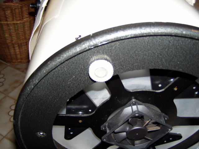

Does anyone know the size, and thread number of the primary cell collimation bolts? I'd like to replace them with knob style bolts. I'm thinking they are metric.

Alan, I have been reasonably successful finding bolts, etc, at Ace Hardware, or other locations with extensive assortments of small parts. However, I could not find suitable collimation bolts for my 12" GSO (HOC) dob. As a result I placed knurled knobs on the bolt ends using epoxy. The attachment was reinforced by boring out the back side of the knob, then slotting the knob so that a thin SS strip could be inserted to fit into the bolt screw driver slot. I can send a few more pictures outlining the construction if you are handy enough to make the fix. Hopefully the picture will be attached showing the finished product. Now instead of using a screw driver to adjust my collimation, it can be done with finger adjustments.
Jud's attachment for post 101045
