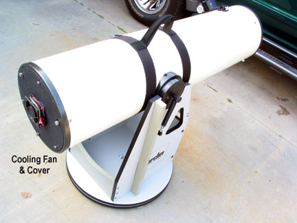

With a solid tube the one fan would be enough if it is about 30-35 cfm flow rated. If you mount it on a plate on the rear of the tube, then it will work well if you pull air out of the bottom. Solid tubes might be better cooled in this way. The jury is still out. Technically blowing on the back of the mirror cools the mirror the fastest, but with a solid tube you have to cool the upper tube too.
You should mount it with some foam or soft material to absorb the vibration, Velcro used to hold it in place on the tube is good.
Here is a Hardin with one of my fan modules installed.
fblue's attachment for post 97585
