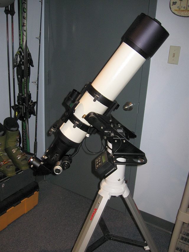

I had my Gibralter(5) mounting plate screwed to the top of the G(5) cradle and works fine. It never occurred to me, till now, that the G(5) mounting plate gets installed on the bottom of the cradle.
Just mount the plate on top of the cradle 8) .
Jim7728's attachment for post 142057
