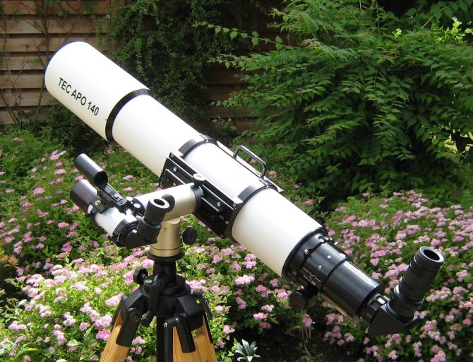

For visual use I'd highly recommend the Swiss AOK mount. I'm using it for four years now without any problems up to any reasonable mag.
See the pic.
Andreas
