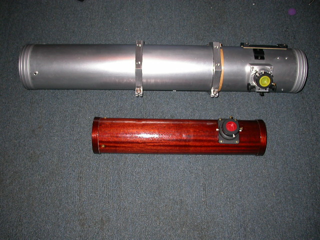

If you want to keep it 'Au Naturel' (short of getting it silver anodized) I can recommend a clear-coat after sanding or buffing to desired level. A fully oxidized tube is a dull gray and still seems to get you dirty when wet with dew.
Attached is a photo of a 7" tube that was sanded with a 220 grit sponge and clear coated with Blair Matte Clear spray (available in most art supply stores). It has maintained it's lustre and does not fingerprint or mar like bare aluminum.
Also pictured is a 5" reverse insulated alum. tube. The interior is flocked and the exterior has a layer of cork covered with a Mahogany veneer. It is comfortable to use in cold weather. The bare alum.(regardless of color) gets really cold in winter (I dare ya to touch your tongue to it). I've had ice form on the clear coated tube AFTER bringing it in the house on cold winter nights. If you observe a lot on those cold Canadian winter nights you might consider insulating the exterior, as discussed in the "cooler than ambient" thread.
My 1/50th a buck, Bob
