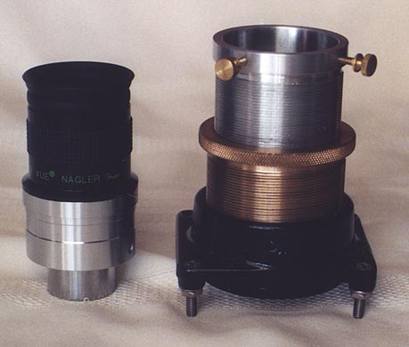

What is the 'best' way to make the focuser hole in a 12" dia. .094 Hastings Aluminum tube?
My last attempt, in a 6" dia. .094, used a round metal hole saw and was messy and needed a lot of filing and cleanup. The center bit drill chewed a bigger hole in the aluminum and the hole saw chattered around a bit. Fortunately, I used one that was smaller than needed so filing cleanup took away most of the damage!
I expect that a 'Greenlee' style threaded hole punch would distort the tube.
I'm putting in a 2" DAR dual Helical Focuser, so the hole will probably need to be over 2 1/2" (I'll get an exact measurement when I take it off the old tube!).
I suspect that there's no easy way, but any helpful hints would be appreciated.

mpupeza's attachment for post 40073
