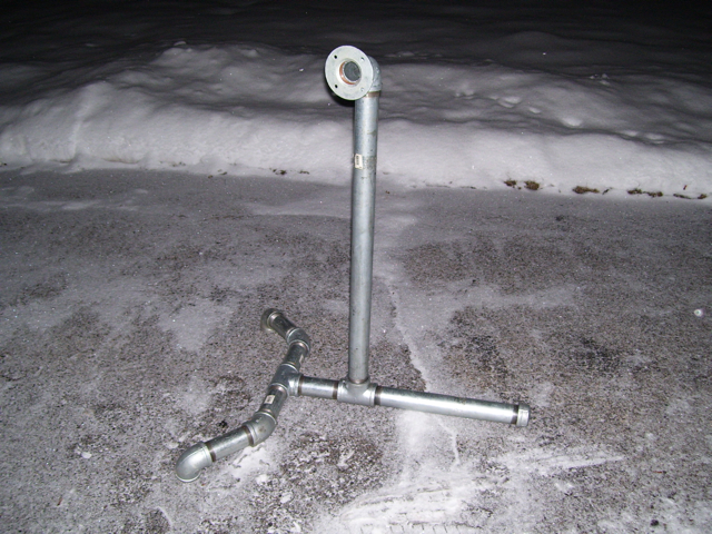

Here is one kind of pipe mount. I use this for multiple scopes, including a 20 lb scope. So I suspect it's heavier than you may want. 2" pipe throughout. It collapses for storage in the car.
Izar187's attachment for post 134817

Here it is collapsed, as it is stored in the car.
No tool set up. Takes about a minute.
Another minute or so to mount a scope via it's tube rings.
Izar187's attachment for post 134818
