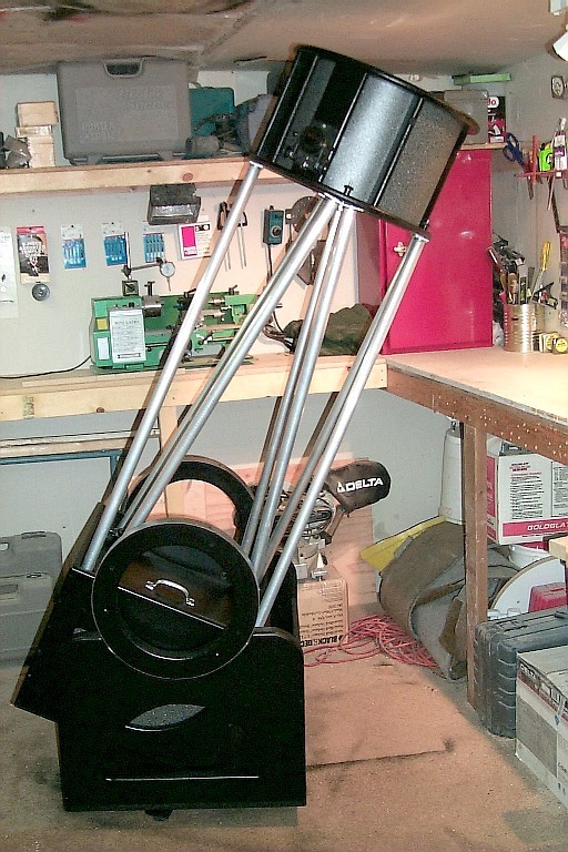

Hi Bill,
It's not an Obsession clone, but I made this budget truss scope for a friend for a total cost of less than $250 excluding optics. The mirrors were taken from a crumbling 16" Meade dob at a cost of around another $800'ish.

Lee,
Nice scope! All black really looks wonderful. While stain shows wood grain and gives the fine furniture vibe, I like solid finishes. Also, you can hide "deviations from the blueprint" behind a few coats of enamel.
It is so great to get a look at everyone's work. It gives me ideas, ideas, ideas . . .
Keep 'em coming, everybody!
