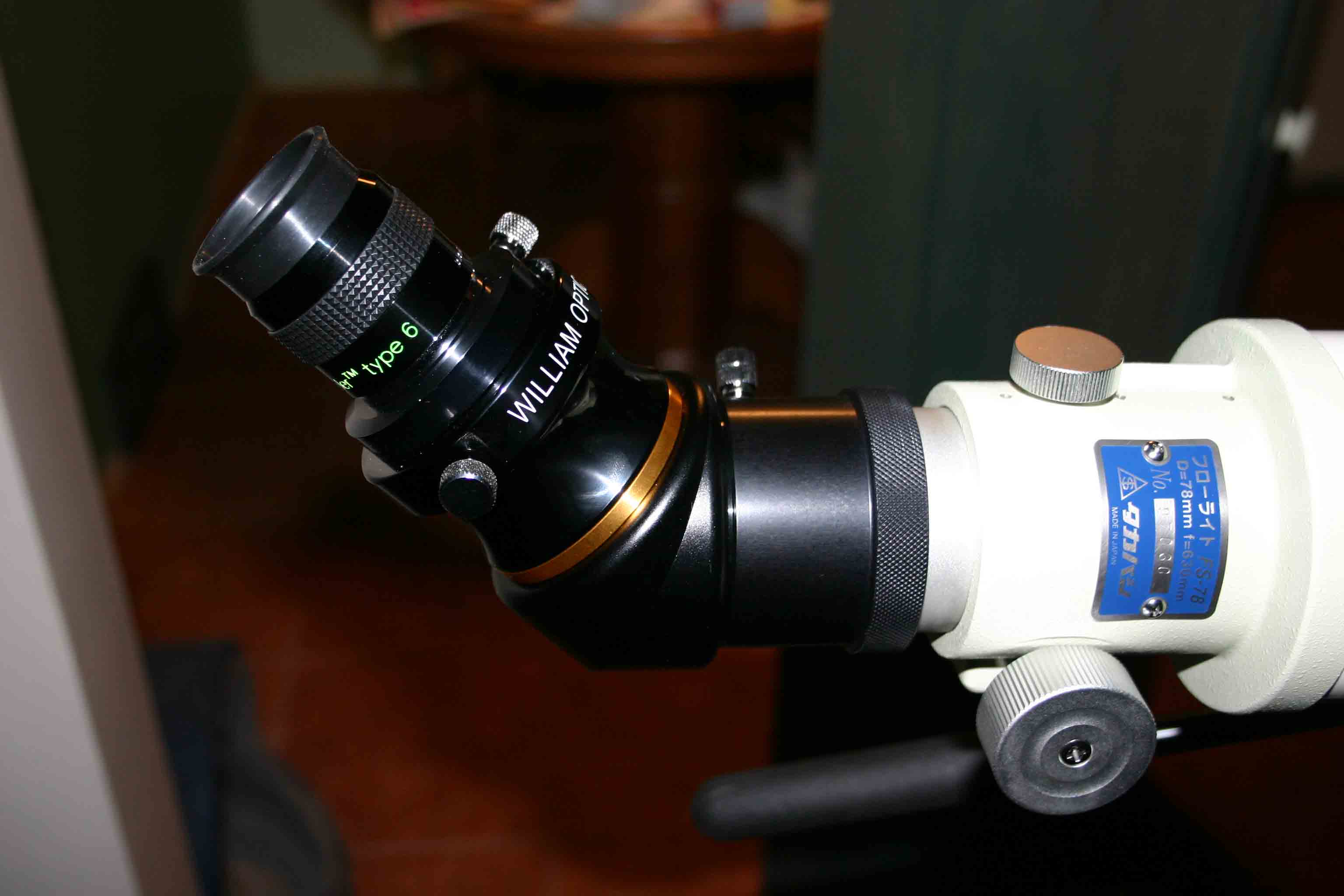

OK, so I have the scope set up like this: see pic
New stuff is the Tak 2" adapter and a W/O 45 degree correcting prism - this replaced the 1.25" adapter that was on the scope before. The new assembly is about 3/8" shorter than the 1.25" one that it replaced.
Tak 2" adapter is screwed directly onto focuser tube
2" W/O correcting prism (diagonal)is inserted into adapter
Either a 35 Pan in the diagonal, or an 11 Nagler (with adapter) Both work about the same.
Instead of the previous problem I posted (couldn't move focuser out far enougn to focus, now I can't move the focuser in far enough to focus.
So how do I fix that? The 2" adapter is just deep enough to accept the diagonal, so I don't think a shorter one is feasible. Is it possible that the scope/diagonal/eyepieces combo I have are simply incompatible?
If so, anybody wanna buy a telescope?
