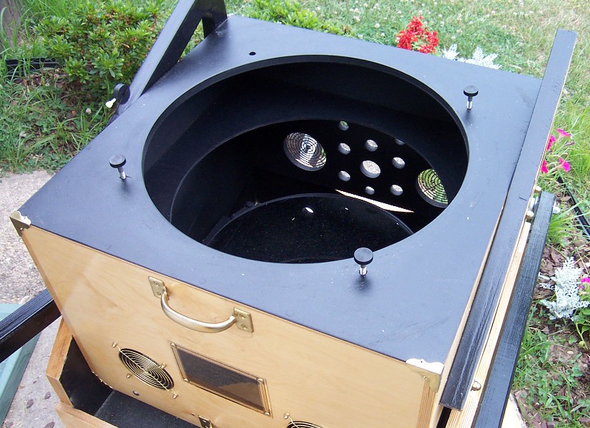

The boundary layer directly in front of the primary and/or secondary mirror surface is the thermal effect you are battling. There are multiple variables that will determine the best solution for your setup (mirror thickness, telescope structure, and temperature variations at your locale).
Dual boundary layer cooling is employed through an array of holes on one side of the rocker box and fans pulling air across the mirror in Teeter designed dobsonian scopes. (see photo). Alan Adler recomends blowing air across the mirror in his January 2002 S&T article "Thermal management in Newtonian Reflectors". Bryan Greer mentions dew prevention as a side benefit of blowing air directly onto the primary, but that photograph showing a fan suspended in the shadow of the secondary directly above the primary with wire... 8O ... Scares me!
