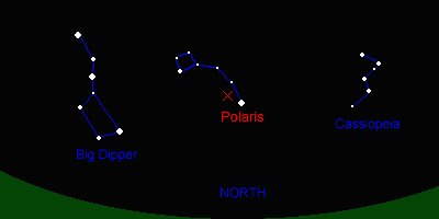

What you describe is exactly what the reticle of a polar finder scope does for you. Just, rather than calulateing the position angle from date and time you just look at the position of other known constellations around polaris.
The red cross denotes the location of the true celestial north pole, about 3/4 degree away from polaris in direction of Kochab, the brightest star in the little dipper. The end of the big dippers handle works as well to determine that direction.
