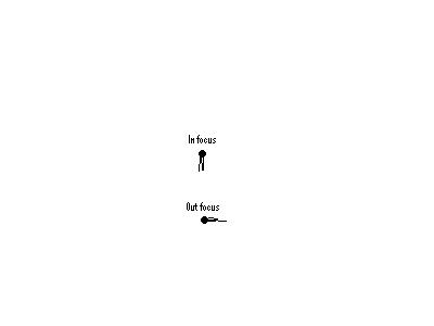

When I put a 1st mag star in the center of the FOV with a 25mm plossl and a 10" f/5 Dob, I see a couple of lines shooting off the star to the "south". If I try to focus to get rid of them, I get new lines shooting off to the "east". I have looked at some examples on the web of what a star looks like with astigmatism, turned down edge, etc., but do not see pictures that look similar to what I see. Any ideas? I attached a picture of what it looks like.

My first guess is your scope needs to be recollimated. When was the last time you collimated your scope?
Posted 08/26/2002 10:37PM #2
Ryan
get scope collimated. Then re startest.
If the images reappear I would guess that it is astigmatism caused by the mirror cooling. Perhaps the mirror is thin and not annealed??
It could also be astigmatism in your eye with the large exit pupil.
Kevin B
Posted 08/26/2002 10:53PM #3
Ryan
I think Kevin is correct about astigmatism in your eye.
The exit pupil for the scope/eyepiece combination is 5mm. If you Barlow the eyepiece or go to a very short focal length eyepiece such as a 5 to 7 mm I bet the effect goes away. If not then your collimation is probably the issue.
Defects in your own eye show up at low magnifications and large exit pupils. Defects in your optics show up at high magnifications and small exit pupils.

Totally random reply, 18 years later.  I was looking at old posts and saw this one.  You told me that the problem might be my eye.  It was.  I was 29 at the time and had never been to an eye doctor - my first visit was not until 2009, 7 years after this post.
I use the dioptrx 150 now to deal with this issue.
So - thanks!

When I saw the old post and my drawings, I showed my wife and said "hey look at this, someone diagnosed my astigmatism 5 years before an eye doctor did!"
I remember the first day I wore glasses after that visit - it was like the world had become High Def.
Anyway, agreed, hope this helps someone.
Posted 10/30/2020 07:18AM #9
This was a fun read...thanks for coming back and confirming the diagnosis! I bought the Dioptrx soon after Televue offered them and have used them ever since. They are a welcome alternative to wearing eyeglasses when observing.
I was at NEAF when they were introduced. Al was manning the booth when I stopped by to inquire about them. When he asked if I knew the cylinder value for my prescription, I had to confess I did not. He asked to take a look at my eyeglasses. He held them at arms length, rotated them 90°, and handed them back to me and confidently stated I needed a 1.5 Dioptrx. He was right on the money!
