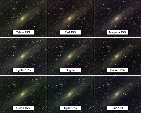

Are there any published setting recommendations regarding RGB conversions that are camera specific. I am using a Canon 30D and and after tweaking and getting the image how I like it in Photoshop, i run Test Strip Proofer and the magenta image always looks the best. The original always looks green. I was curious if anyone has experience and could point me in the right direction.
See attached example
Thanks for the help!
-KDG
kgav8r's attachment for post 39343

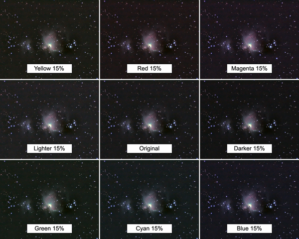

Here is another example
kgav8r's attachment for post 117885
Posted 10/23/2007 10:44PM #2
Kerry,
There is a table in HELP
For the 30D use:
Red 159
Green 100
Blue 126
Probably need to have X & Y Offset checked.
