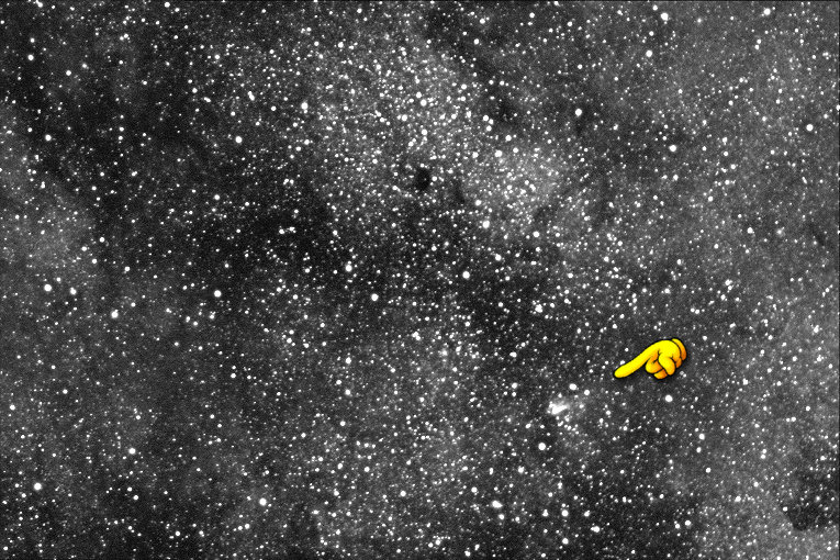

A simple example of the results can be seen here in my first attempt at using the adapter, my Olympus M-1n and one of my Zuiko lenses (see attached image). I have pointed out the Swan nebula in the FOV.
