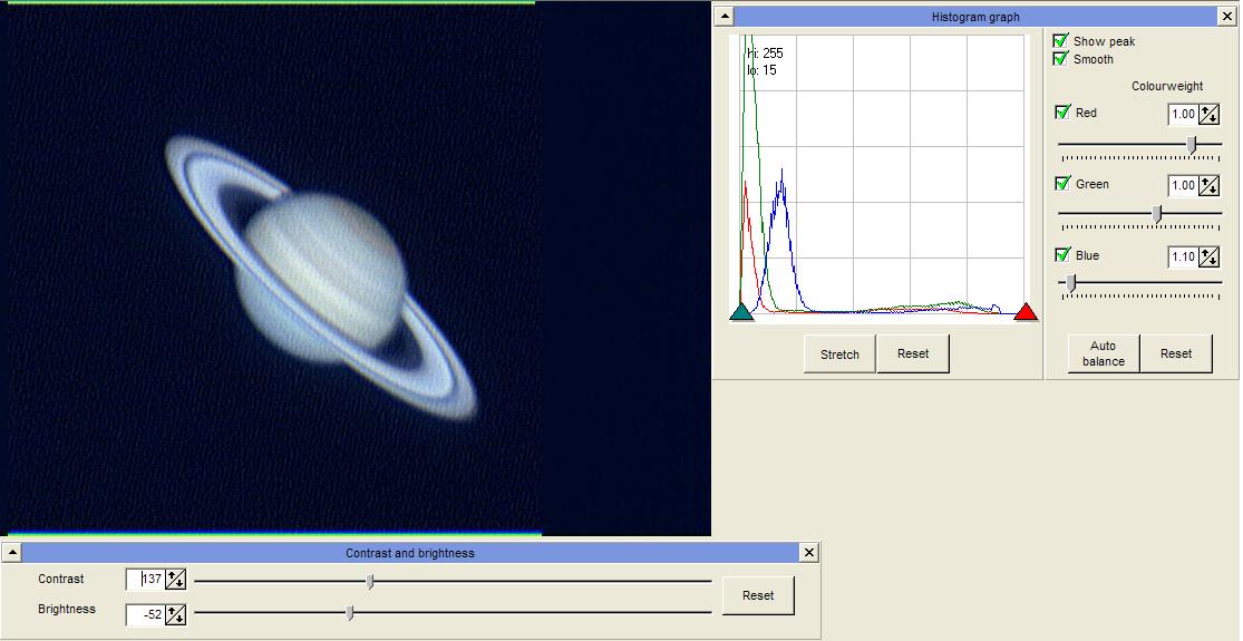

Generally a nice image though. Here it is after a couple histogram tweaks in Registax...
