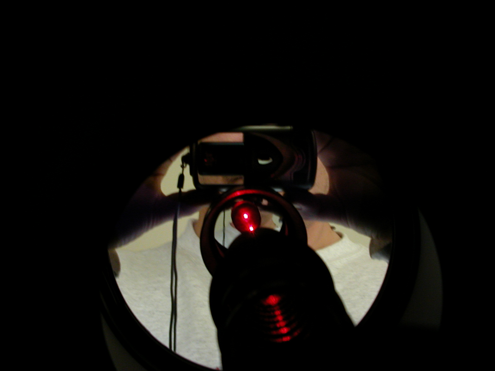

I can not get a pin point star? I mean even after the scope is cooled down, i have never been able to get pin point stars. I threaded a Kendricks 2" laser to the rear cell and the beam does not even come back to the laser, it sits on the other side of the return baffel.

I will take a pic with the laser hooked up to show what i mean, but i cant for the life of me imagine the mirrors being off that much as the Moon and Jupiter to come in very clear.
