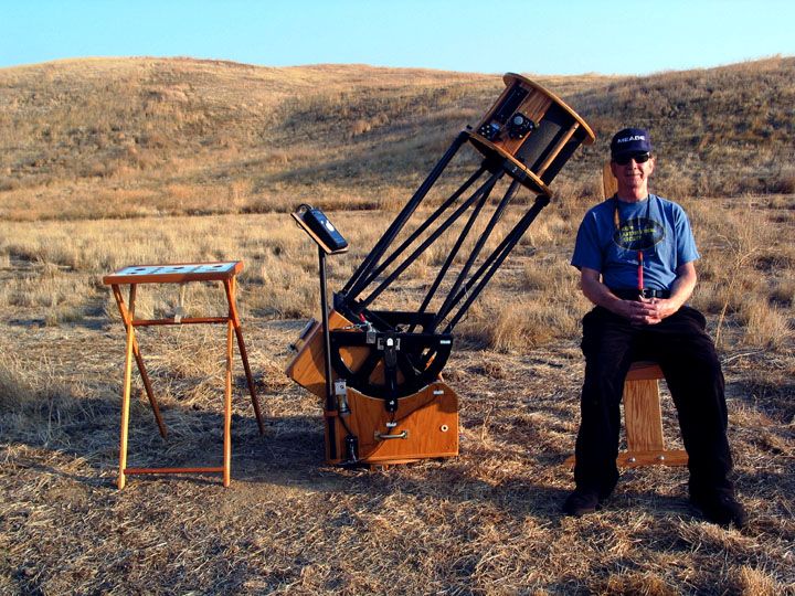

I too own a Starmaster 14.5" f/4.3 with a 1/30 wave Antares secondary, ServoCat and Argo Navis, mirror box lower baffle, UTA upper baffle, UTA flocking, enhanced light shroud (thicker more opaque fabric than the stock one) upper and lower cooling fans and completely aligned optical system.
Most of the add ons were of my own design from my company, Blue Sky Accessories. But, if you make your own that is just as good.
By adding these items and maximizing the performance of the 14.5" Starmaster, it is on par with even an 18" scope. It does not quite have the brightness (slightly less) of image, but otherwise it is comparable. Even when I look through much bigger scopes, 20-24" the differences are less than one would expect.
Plus, I get to sit in my chair to view, even at zenith or stand flat footed all night with no steps what so ever. This to me is such an advantage over the evening, that I feel the loss of aperture is worth it.
I have owned scopes where I used a short ladder and have viewed with scopes that needed tall ladders to short ones. Even the ones that needed a short step ladder got to me over a nights use. The constant moving it out of the way and placing it for the individual using it, just got to be a hassle to me. Now I have a 6" plastic platform about 12" x 30" for my wife to use that is light and will not tip or move. It is not bad and it is only used when a person under 5'4" is at the EP and then only when the scope is aimed high.
I believe that you can optimize a scope and gain a bit of performance. I also believe that aperture rules generally, but for me too much is too heavy and difficult to set up as well as use for 8 hours.
