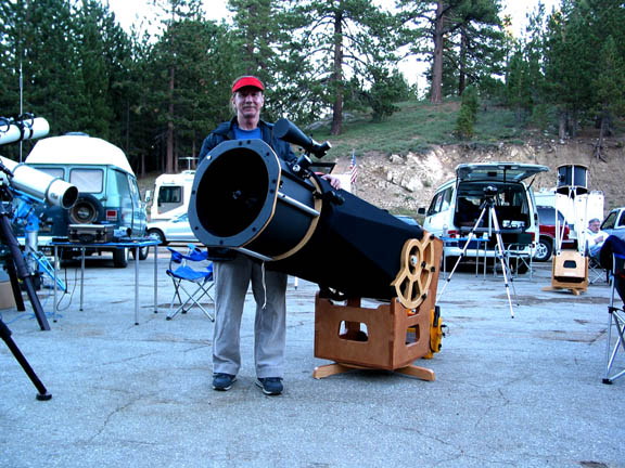

A 15" scope is BIG, I have one. My 12.5" scope next to it looks small. My friends 10" next to the 12.5' looks like the 12.5 next to the 15". Make sure you can transport what ever your buy. It must fit your car and your ablility to lift it.
The picture is of the 15" behind me is my friends 12.5" like my other one.
