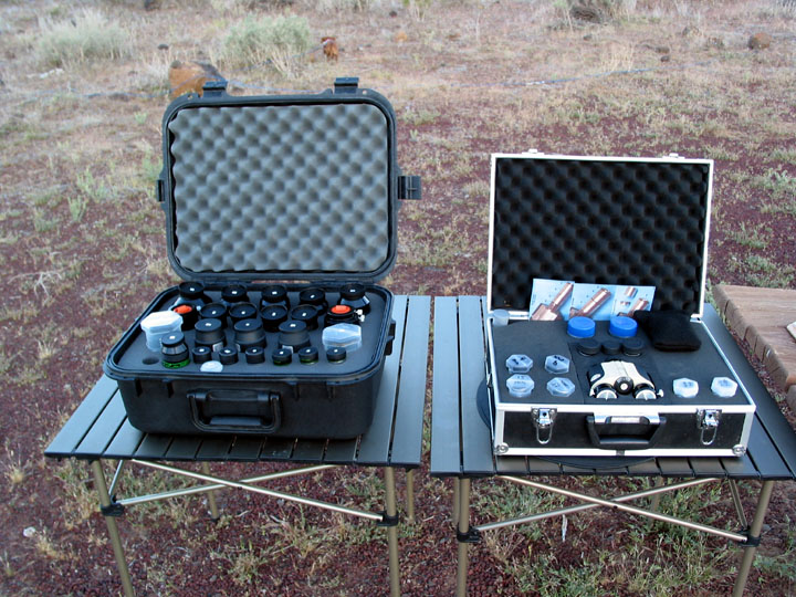

lintonius's attachment for post 112578
Posted 03/22/2007 03:11AM #2
Hi Jud,
I cut all the way through, it is too difficult to make a partial cut and get a good bottom to the hole.
Then, as Linton says, I cut a piece from the cut out to fill in and make the proper depth.
I use a serrated fillet knife with a very thin blade to cut shaped or contour fit holes. I use a hole saw spun in the reverse direction to cut round holes.
I have also used a band saw for a large cutout for a scope for instance.
Cut slowly and carefully and lay out the whole case before you begin. Large EPs can lay on their side or if the case is deep enough they can all stand on end and use round holes.

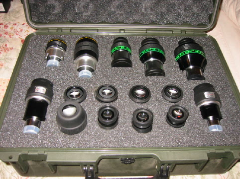

fblue's attachment for post 112582
Posted 03/22/2007 05:30AM #3
Hi Bill,
If regular foam, like upholstery foam is used, then the freezing can help a lot.
The type of foam being used in this case is easily cut without freezing and is much nicer to work with when making complex cuts or cutting holes. smile The Charcoal Foam is made for cases and cutting to shape for tools. Nice stuff really.
