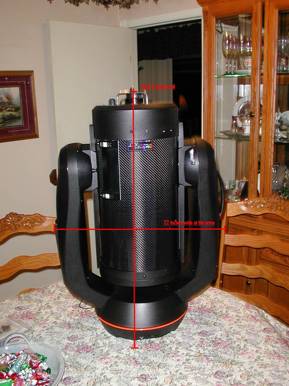

Again, I apoligize if these are dumb questions, I am just trying to get up to speed. Thanks allot. I attached a pic of my scope just for fun. (sorry about the type on it, I used it for my case design)
dalbertson's attachment for post 14146
